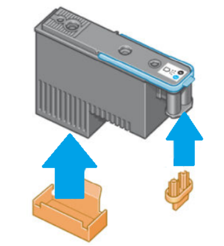

2. If the orange (white or transparent for the optimizer printhead) caps that came with the printhead are available, gently clean the black sealing rubber inside with a lint-free microfiber cloth and distilled water, in order to remove any dried ink or fibers that could be present. Once clean, make sure to completely dry the black sealing rubber with a dry lint-free microfiber cloth before capping the printhead.
3. Remove the printheads and protect them with the orange (white or transparent for the optimizer printhead) caps. Make sure to cover the printhead needles with the orange protector. Once the printhead has been removed, store it in an upright position with the orange caps facing upwards. If the caps are not available, it is better to keep the printheads installed in the printer.
IMPORTANT: Make sure to remove the printheads only if the orange (white or transparent for the optimizer printhead) caps are available. Otherwise, the printheads will probably get damaged.
IMPORTANT: Ensure that each printhead uses its own sealing cap and not one from another color printhead. This is especially important with the optimizer printhead caps, as there is a risk of nozzle damage if they are used with the color printheads or vice versa.
IMPORTANT: Ensure that each printhead is stored with the orange cap facing upwards. Otherwise, the printheads will probably get damaged.
