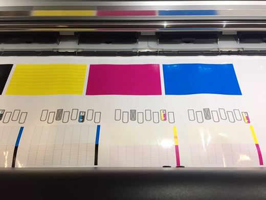

Users suffering from ink migration will see one ink color flowing into another color. As a result, ink mixing issues can cause image quality defects.
The root cause has been found to be ink flowing from color to color within the same printhead. Ink mixing is most noticeable between yellow and magenta colors, but can also be seen in other colors. In the example below, you can see magenta ink bleeding into the yellow channel.

1. To identify ink mixing issues, print a printhead diagnostic plot. To print this test, go to the printer’s front panel and navigate to Settings > Image Quality > Clean Printheads > Print Test Plot. If the printer is suffering ink migration, you will be able to see the ink flowing from one color to the one next to it in this portion of the plot.
2. To recover the printhead, print a block of 90 x 30 cm or 36” x 12” in the color suffering ink migration. For instance, if you see magenta ink migrating to the yellow side of the plot, print a block of yellow.
3. After flushing the ink from the affected color, print a second Printhead Test Plot to validate the issue has been solved.
