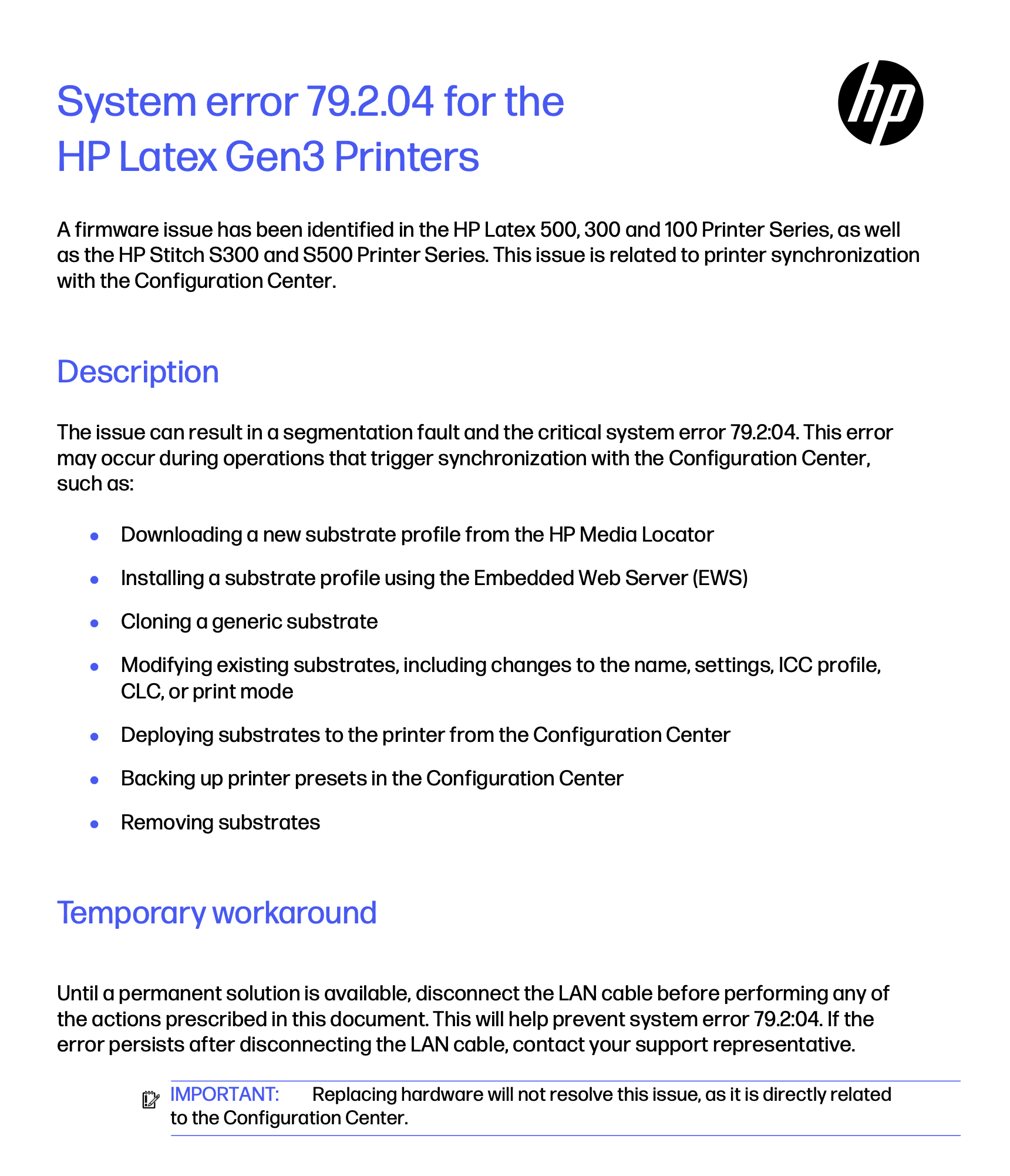

System error 79.2.04 for the HP Latex Gen3 Printers
#1 Drunknmonk 4 months ago

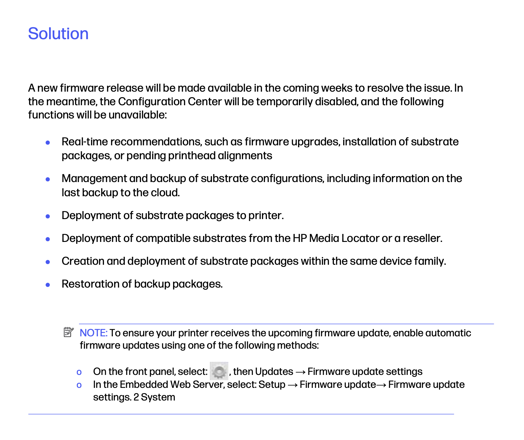

They have found the problem, May 2025, but does anyone know how long it will take them to fix it ?
#2 printertales 4 months ago
#1 said They have found the problem, May 2025, but does anyone know how long it will take them to fix it ? Reply turn off the printer, unplug the network cable, turn it back on, then disable Web Services in settings. After that, plug the network back in. HP’s still working on a proper firmware fix

I recommend that you Regularly check the HP Support site, Firmware Downloads for your printer model.
