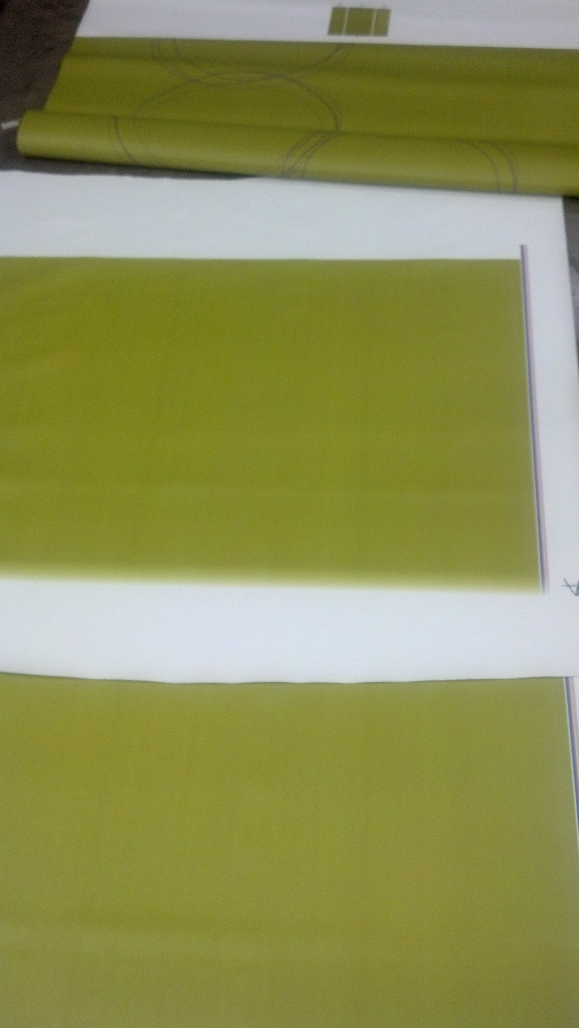

We have had trouble with 'solid color area’s' streaking (vertical) on Korographics Abaco Beach and Dreamscape Suede. We are printing a dominate green solid with circle patterns. Because it is across 2 different materials that tells us it may be a heat issue or at least printer related. Have you come across this before? Even if you have not, would you have advise for us?
See image

#4 HP-MarcM 8 years ago
Hi digitalGuy,
Vertical banding is a IQ issue related with the temperature. All the information related with troubleshoot print-quality issues related with vertical banding are explained on the User Guide (Chapter 13; page 130 on English version). Even though, let me provide you some advises:
  • I will recommend you to print using the HP Certified profiles for your medias in case they exist. I know that for the medias that you are using, there are some HP Certified profiles. You will be able to find them at HP Media Solutions Locator.
  • Pre-warm the printer. Results are always better when the printer temperature is stable that is why usually worse with the first plots.
  • Load the substrate in the second/centre position to maintain more stable temperature along the substrate.
  • Decrease dryer temperature to minimum possible.
  • Increase the number of passes.
  • Use the inter-swath delay thru the RIP or front panel.
  • Activate the “Vertical correction” feature by front panel (Options > Ink > Image-quality maintenance > Vertical correction). Once you fixed the problem of the vertical banding I will recommend you to disable this function for other jobs.
I hope this helps
