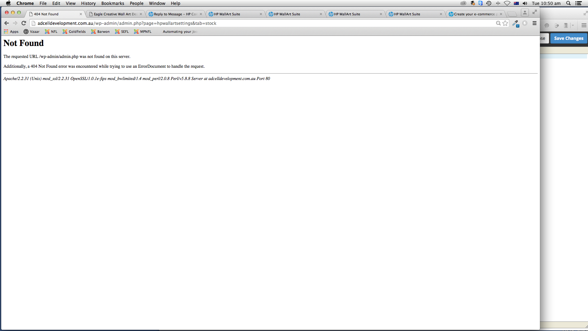

#94 sunnyAdcell 9 years ago
Hi There, I have installed HP Wall Art Plugin my wordpress site and followed all the seteps, in plug in options of Stock imagery options and SKU Options, when i click them to set the Credentials. I'm having 404 error as soon as i click them. attached the screenshot, please help with this.
Was this helpful?Yes0 No0
How can we improve it?
#95 HP-MarcM 9 years ago
HI SunnyAdcell Seems that the problem described that affects your HP WallArt Plugin could be related where you installed the WP Plugin. Make sure that the path installation is on its root path instead of installing it on another path. On the other hand if the problem persists our best recommendation would be to contact our Support Team, hpwallart.support@hp.com, that will be happy to help you to get through this error.

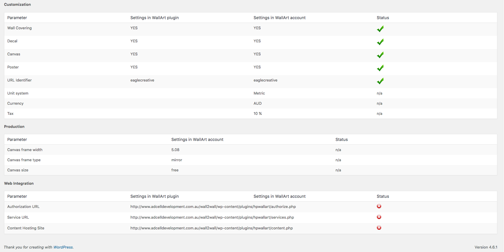

#98 sunnyAdcell 9 years ago
Hello, I Have installed HP Wall Art plugin on my wordpress site and works fine doing orders and payments perfectly. I just got and update from plugin and updated to the newer version. After that, my Hp Acoount not linking with plugin. Haven't changed anything. Wall Art Data links all displays red that means not synched with hp account. Doulbe checked the the path and account details all looks good. Any help would be appreciated, Attached the screenshot, thanks.
