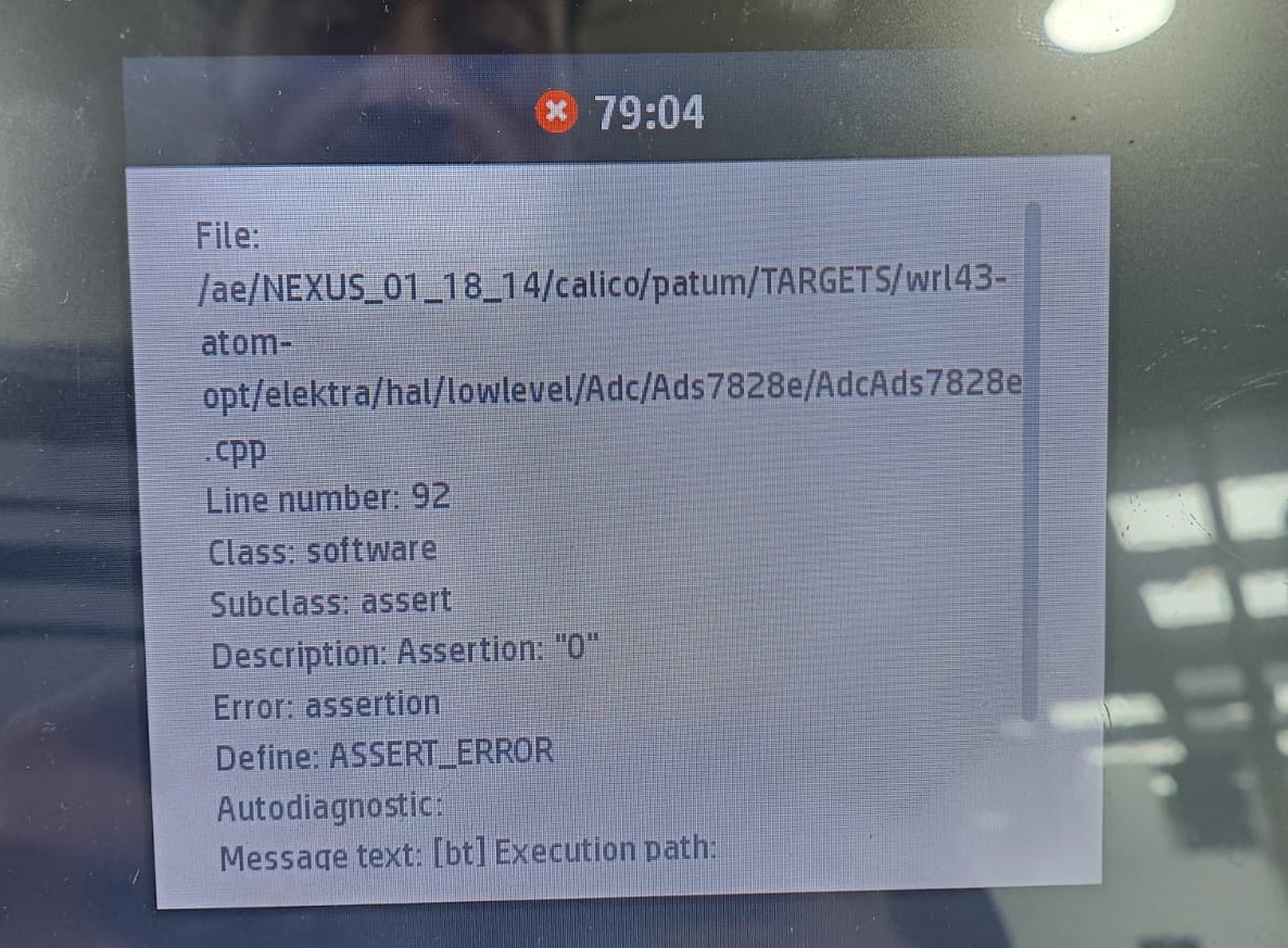

Receiving Error Code 79:04 during Initializing on the Latex 370
#1 naeemskhan2171 5 months ago
I have a Latex 370 machine. When I turn it on, it initialises, but when the Bar reaches 43%, a 79:04 error code appears. I even removed all the print heads and inks & restarted it, but it's useless. If anyone has faced the same scenario, pls guide us
#2 printertales 5 months ago
#1 Hey, had the same issue with my Latex 370 before. That 79:04 error usually points to a firmware or formatter problem. Try doing a hard reset and updating the firmware via USB if you can. If that doesn’t help, the formatter board might need replacing. Hope this helps!

#3 zunairmajeed 4 months ago
#1 said I have a Latex 370 machine. When I turn it on, it initialises, but when the Bar reaches 43%, a 79:04 error code appears. I even removed all the print heads and inks & restarted it, but it's useless. If anyone has faced the same scenario, pls guide us That error usually points to a firmware or communication fault. Try restarting without network/USB cables, unplug for a few minutes, then power back on. If it still stops at 43%, reinstall or update the firmware. If that fails, the formatter board may need service.
