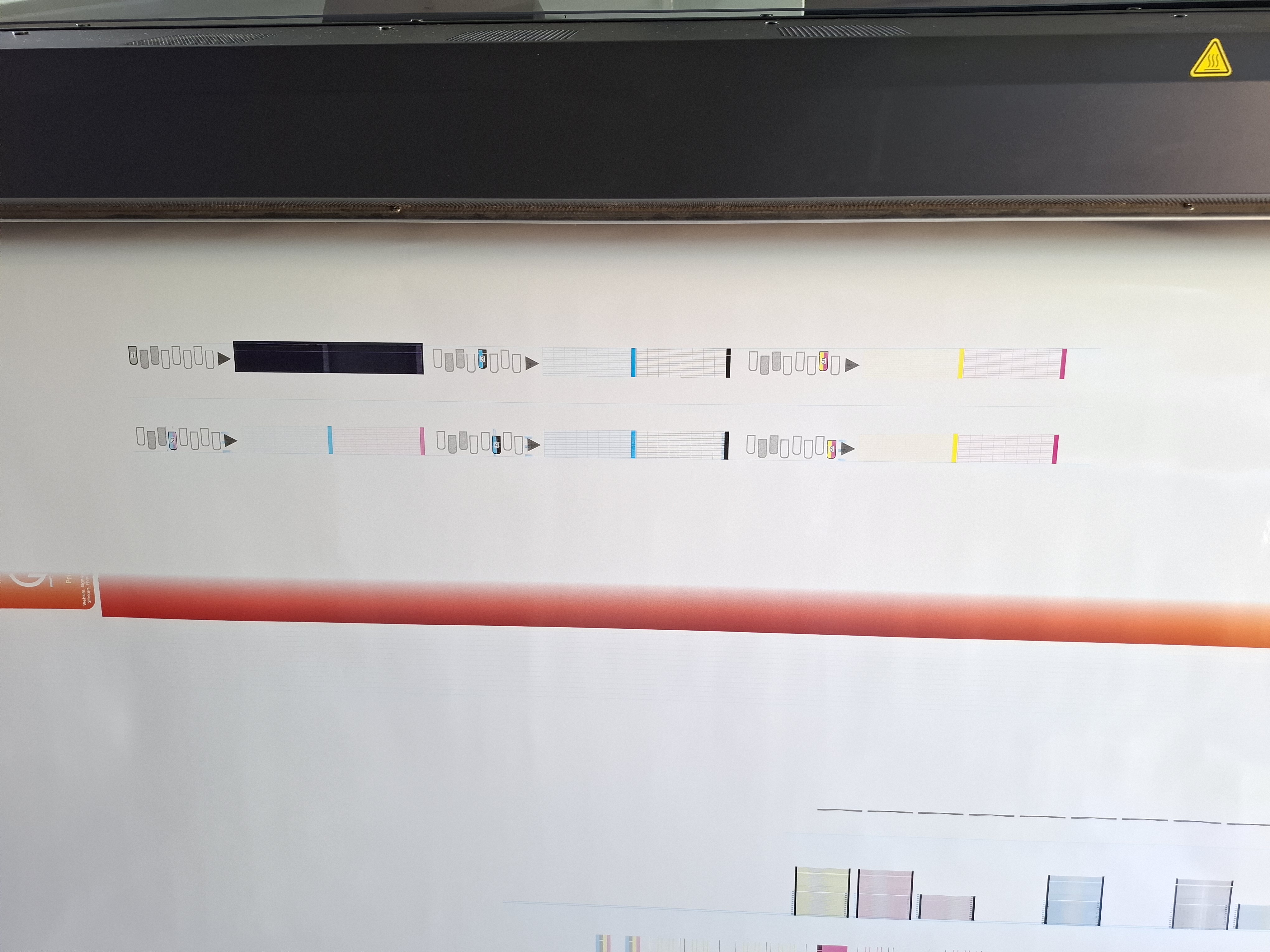

Hi Please just see linked pictures...have you ever seen this Printhead issue ?Printer prints well and sometimes I can see some light Cyan stain streak. I can see it very rarely. It usually arrives after 3 meters print interval.Most of the time, customers never see any issue but sometimes tbis issue could be visible.I have run printhead cleaning and this light cyan printhead had printed only 300ml. Have you ever seen a similar issue ?

We seem to be having the same issue on our Latex 360. Its much more noticable in teals and some darker blues. Have you had any luck correcting it? We recently purchased a 570 and the 360 has become our secondary machine. I'm going to reset everything to factory and recalibrate everything I can. Replace all printheads and do come cleaning. I'll let you know my results.

I have replaced Light CYAN printhead and it seems to solve this issue. Just replace the printhead and please let me know if it solves your problem ?

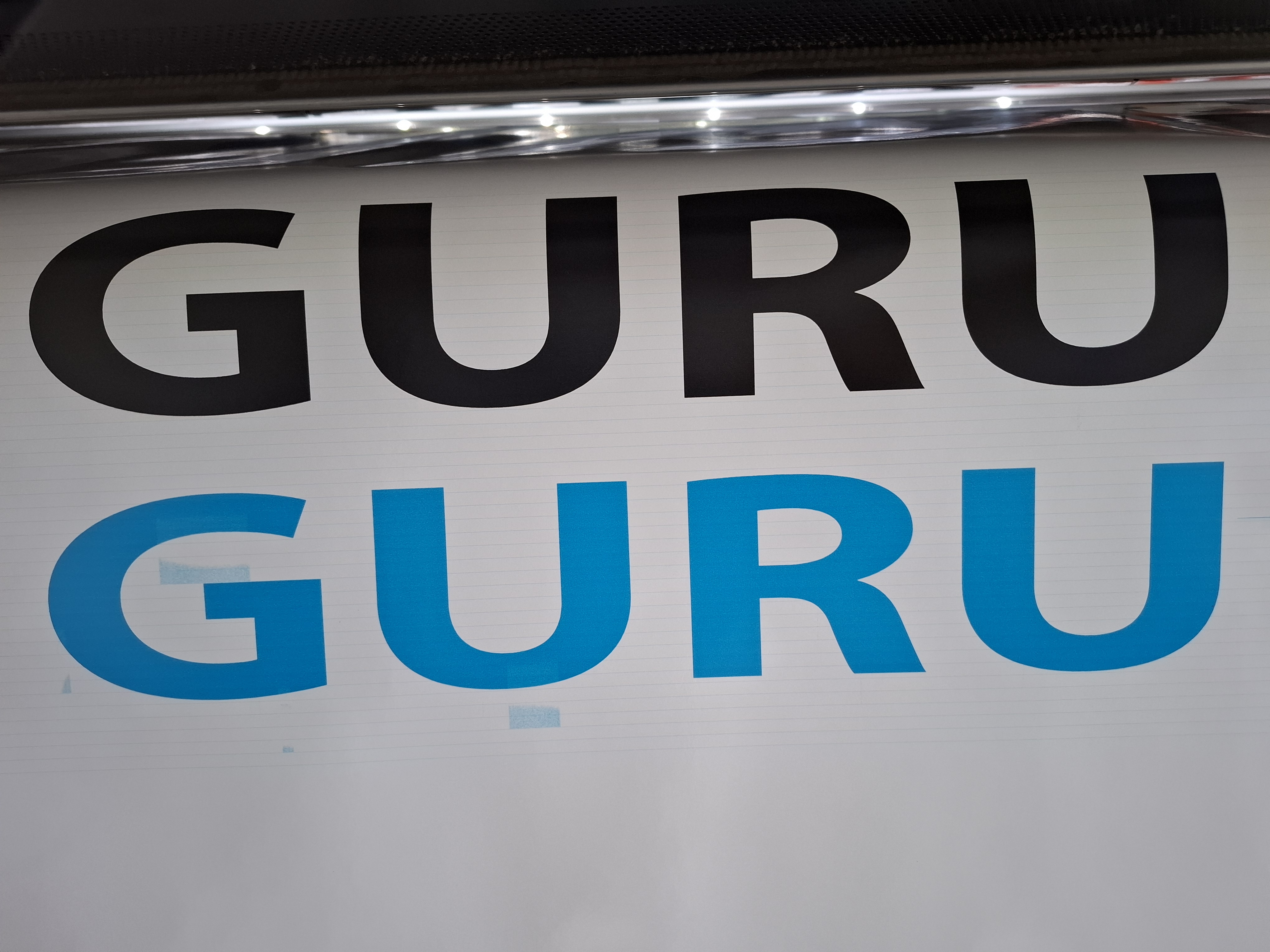

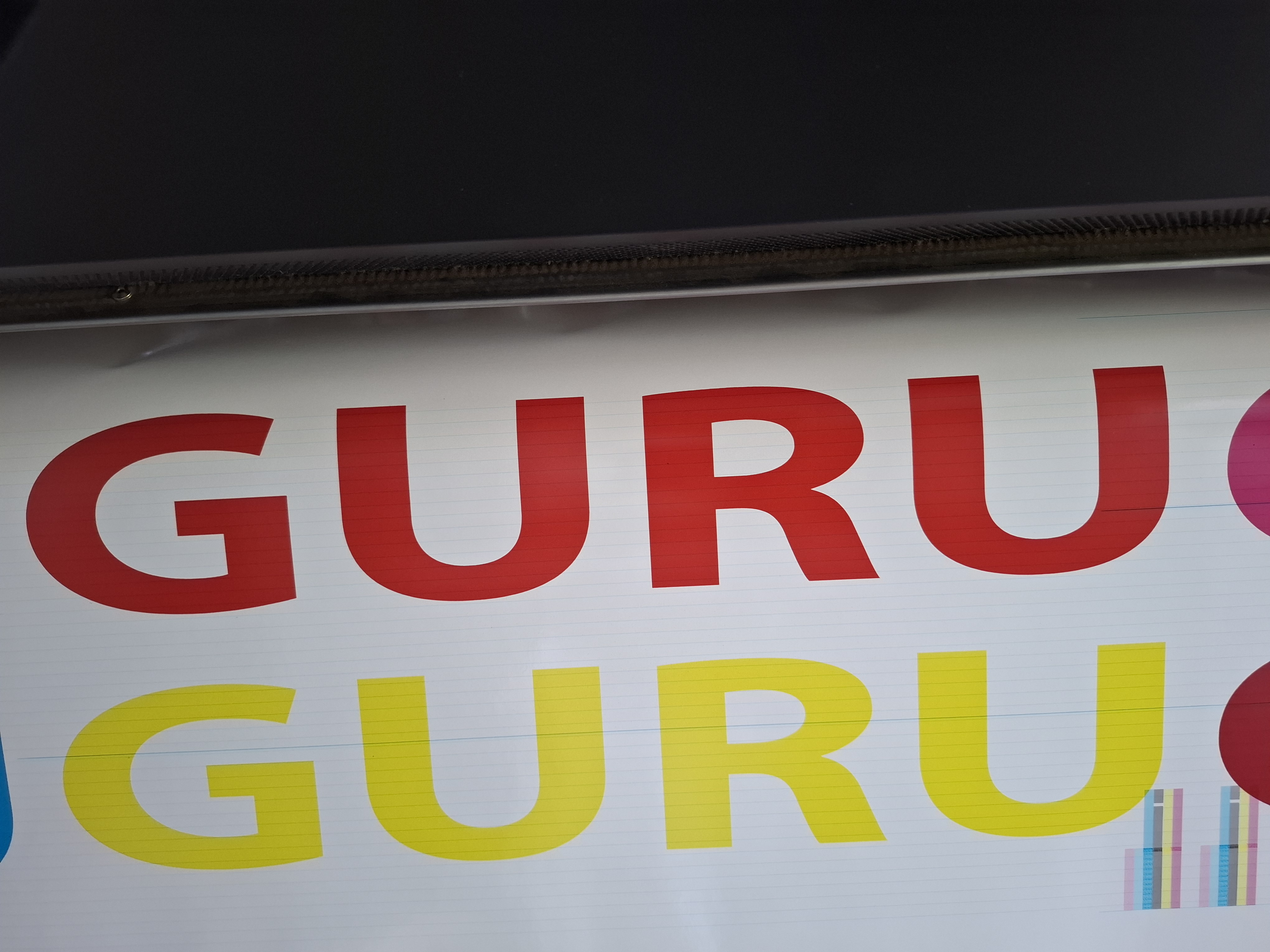

Hi, I have same problem with my HP Latex 360 printer. Cyan tiny lines coming all the way across media. It is printing perfect but getting lines. It is not banding. I have replaced both print head Cyan/Black but no luck. Run cleaning cycles couple of times & align print head but still no luck. I checked everything. Clean encoder, replace new cleaning cartridge. If you print small image, it is still printing Cyan lines across media. Please see attached photographs.
