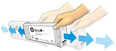

4. If the printer has a 3-liter kit, remove each cartridge, place it on a flat surface, and turn it 360 degrees four times.
5. Remove the ink cartridges using the ink menu option on the front panel “replace intermediate tanks” or “ink cartridges”, depending on the printer, and shake them for 15 seconds before reinstalling. If the printer has a 3-liter kit, do the same with the intermediate tanks.
