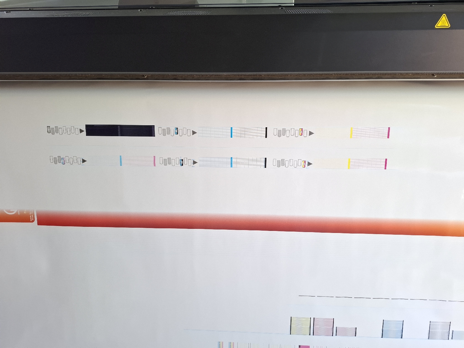

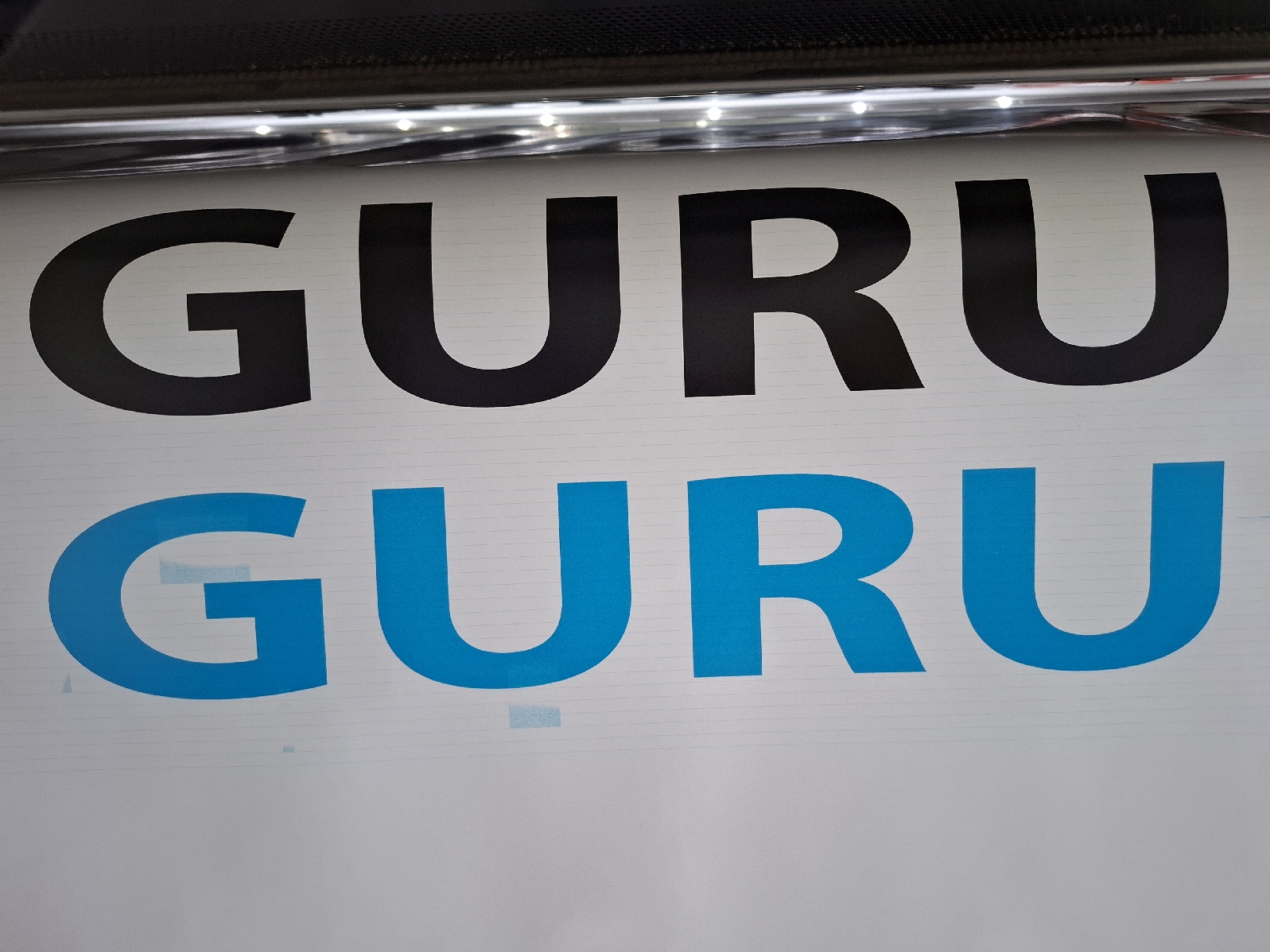

Hi, I have some problem with my HP Latex 360 printer. Cyan tiny lines coming all the way across media. It is printing perfect but getting lines. It is not banding. I have replaced both print head Cyan/Black but no luck. Run cleaning cycles couple of times & align print head but still no luck. I checked everything. Clean encoder, replace new cleaning cartridge. If you print small image, it is still printing Cyan lines across media. Please see attached photographs.

#1 said Hi, I have some problem with my HP Latex 360 printer. Cyan tiny lines coming all the way across media. It is printing perfect but getting lines. It is not banding. I have replaced both print head Cyan/Black but no luck. Run cleaning cycles couple of times & align print head but still no luck. I checked everything. Clean encoder, replace new cleaning cartridge. If you print small image, it is still printing Cyan lines across media. Please see attached photographs. Reply Hey, had the same issue on my 360 a while back, turned out to be the optimizer not firing right or over-spraying a bit. Try swapping the optimizer printhead or check for any leaks/dried nozzles there. Also, make sure media presets are spot on for the material you're using. That fixed it for me. Good luck!
